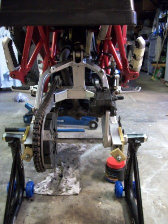

Does anyone know much about these, have picked up a was running well '89 750 Sport with all of 5200km on it (yes it's true) which I'm doing a minor restoration on, and it has a set fitted, the bike has been in storge for god knows how long, few bits perished with age but all over fairly good, have been trawling through the site which has a great wealth of info on it, love the one about changing the belts with pictures and arrows is good stuff (have new belts ready to go), but haven't come across anything about the Keikin's good, bad or indifferent, so not a popular conversion?, the ones on mine have just popped the float needles so an exhuast full of fuel, not alot of fun, bike is nearly completely original apart from the carbs, and the fairing lowers being cut off, which will be fixed in time, and is intened to look as original as possible barring the Conti's, use to own 600 Pantah's back in the day so the motors vaguely familiar, but don't know Oil Capicity for engine or grade of fork oil and amount, torque values for axle bolts etc. File comment: 3 quarters finished

PS: are those mounting stand knobs on your swingarm welded on on just screwed in?

Thanks for that guys, will delve deeper into the site, just measured them and they are 39mm, have found the distributor for Oz so can now order a rebuild kit for them. Yeah the crank breather pipe is fairly dodgey and will look at doing something a bit neater, the rear race spools are a temp I drilled/tapped/fitted just so I could work on it upright and get the back wheel out for new rubber etc. they will be removed and the holes plugged. Parts of the bike have come up like new, other bits should be replaced but don't have the budget at the moment, stupid thing is I was getting it ready to take in for a Engineers Certificate which is required here for a direct (grey) import from another country in this case Japan, to be able to register it and was doing a final check over and thought Hmm is something leaking fuel, just knew it was all going to well, Murphy had to stick his hand in somewhere.
