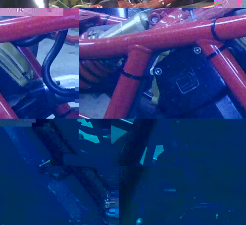

Hi,
I bought newer plastic case Ducati breather and have turned it to smaller diameter.
So it now fit to replase the original hose connector in crankcase. It's connected to original bottle.
