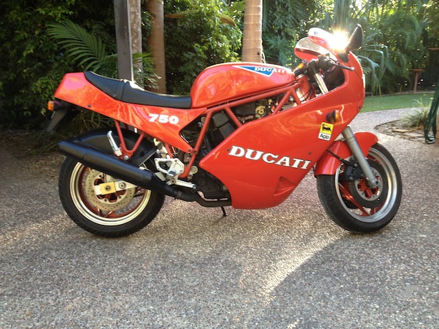

:wink: Hi guys, im new to here, just picked up a 1988 Ducati 750 sport 11000km in mint condition, has obviously been dropped at some stage as the fairings dont have the original blue decals on them, a big thank you to Paso750 grand poo bah, we are truely not worthy of you oh great one,for information on where to source a clutch from http://www.stein-dinse.biz/Ducati/Clutc ... 2_739.html, i spent at least 10 hours hunting around on line, went to paso750 poo bah's reccomended site, and voila there they were.
Bike starts and runs fine but i notice when stopped at the lights, the clutch is grabbing and nearly stalls, also difficult to get into neutral. Have done a hydraulic oil change and adjusted the clutch lever to the full extent, no oil leaks at either end. The clutch plates do have scoring and pit marks on them, may try rubbing them with a bit of wet and dry sandpaper.
Any ideas would be much appreciated, hydraulics or clutch plates/springs. What do you reckon ?
