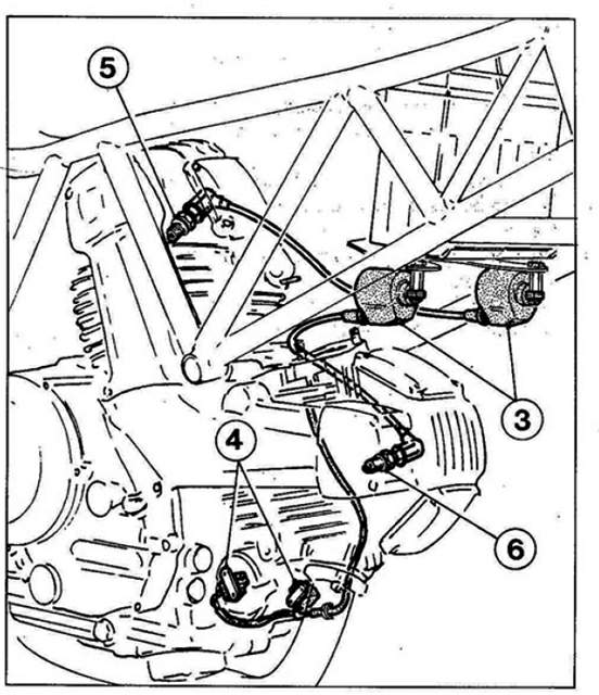

Can someone please confirm the the lead from the nearest coil ( right side when sitting on the bike and longest lead ) goes to the rear cylinder.I'm pretty sure it does but did'nt get a good photo of it when I took them off.

that old wiring "repair" just demands for some cutting pliers or better soldering ... :truck: I hate electrical tape - so much. Over time it will come off dry and all the sticky crap remains on the wiring and everytime you touch it you have it all over.
Did you have a peek inside the carbs float chamber or are you risking it ?
I just noticed that I have the habit to tie the cable ties differently than you. I like to have the lock on the lower inner side of the frame as I cut off the long ends and in the past for some reason ocassionally managed to cut myself on the sharp edges. :roll:
As for the coils it makes more sense to have the coil for the vertical cylinder on the left which is also what the owners manual shows. At the end it doesn`t matter as long as you connect them to the correct CDI unit ;)
