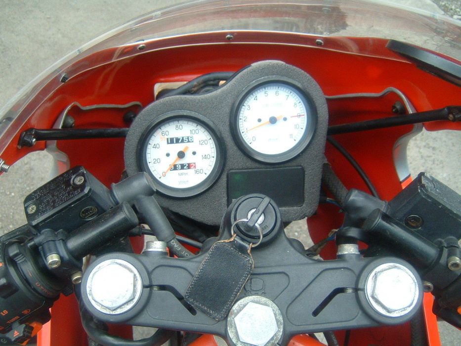

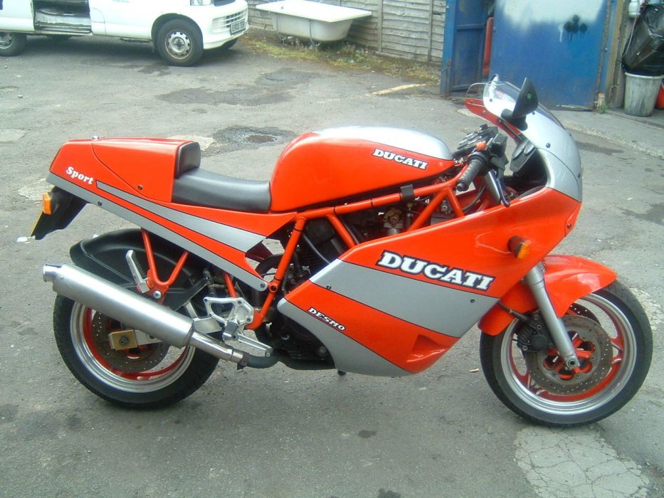

Peter... Pics attached.. i think...
Tony
Im going to keep the stock Webber... do you know where I can get some nice flutes or horns for the top of the carbs?

That's a nice Sport Tony.Do yourself a favour and check for cracks in the swingarm.They are renown for it.
Andrew

mind you, that is the later model braced swingarm so it should probably be OK.
