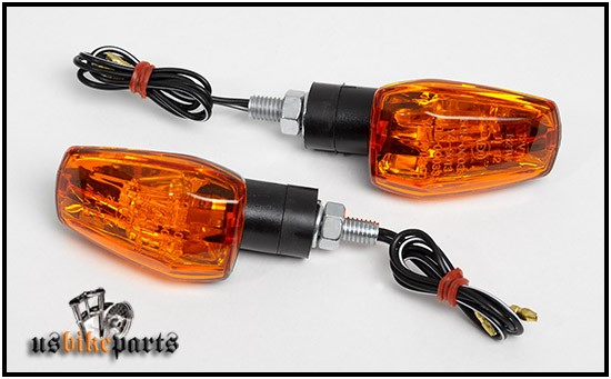

Btw some similar aftermarket parts don`t look so bad and are probably cheaper.

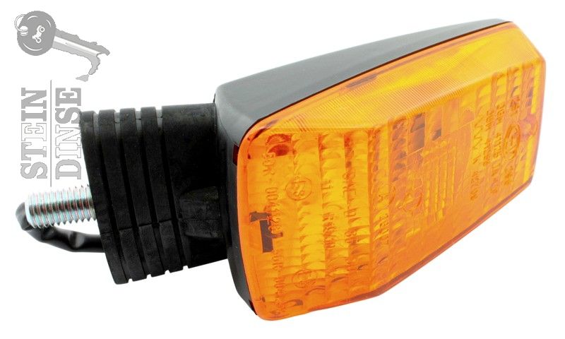

http://www.stein-dinse.biz/Ducati/Elect ... 52101.html
2004 ST4S
2001 ST4
1987 Paso 750

Stein Dinse doesn`t have them, they can only preorder them.

I ordered mine from Stein Dinse and they shipped them promptly.
