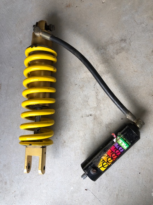

Can anyone ID this shock? It has no parts number on it that I can see. There is the remainder of a name on the label ‘Pulsar’ and Valvular system but no brand name i can see. It was supposed to be a Marzocchi but no evidence. 6CEBF5F1-B7AC-43F3-9A20-29B3D839982D.jpeg

that above the "Pulsar" is the M, the Marzocchi logo.
The spring may have been replaced. Yellow is typical to Ohlins.
Here're a few pics of a disassembled Pulsar3 which may be a later model.
https://www.leguidevert.com/viewtopic.php?id=307399

Thank you. I had been over complicating my searches otherwise I would have found that first time!!! I didn’t recognise the logo. It’s a good find it seems, if it still functions. Will take it to my local suspension guy.
