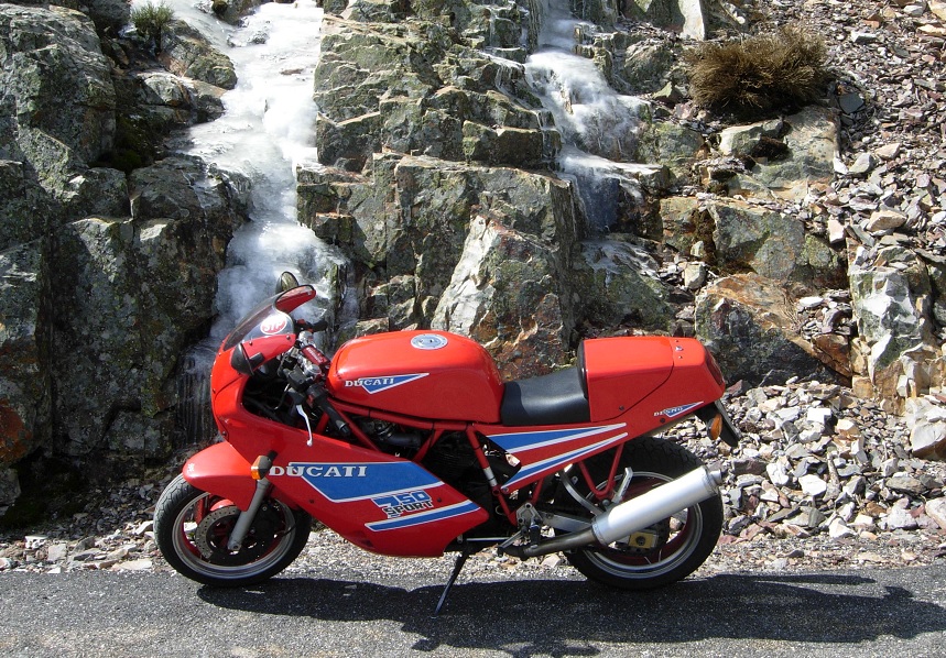

I want to get back on the road with my ducati 750 Sport, which I had in a corner of my garage.

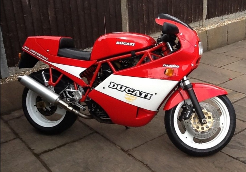

I have come back strongly, and I bought a 900 Supersport 90 in England.

I think that to return, I've bored them enough with my message, and it's time to present my bikes.

Btw. that is a nice and clean looking 900SS :thumbup:
