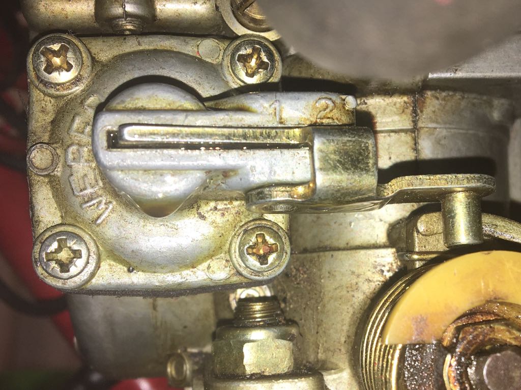

Hi,
What is this part of carb and how can I prevent it from leakage? When turning the gas handle this part moves and starts to drip a little gas over time...
 Post subject: Re: Gas leakage from carb, 750s
PostPosted: Thu May 31, 2018 8:26 pm
That's the accelerator pump. There's a membrane behind the cover that may need to be replaced.

Got one from local bike part seller. Hopefully it is the right part :)
PostPosted: Fri Jun 01, 2018 7:19 pm
All Weber DCNF's use the same one

That fixed it! Great, once again thanks to you guys :)
This also fixed the rushing issue and bad idle running I had in my other post.
