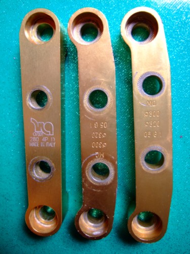

The drawing was made many years ago in Powerpoint. :truck: Unfortunately I have no skills using AutoCad.
The dimensions if you refer to the distance from the top or bottom edge to the caliper mounting holes are indeed the same. The difference is the offset.
On this pic from left to right you see the 280 adapter (in the 280mm disc position), the 300/320 in the 300mm disc position and upside down for a 320mm disc.
If you turn the 280 adapter upside down it will fit a 300mm disc, too. The caliper will have less offset compared to the 300/320 adapter but sit higher. To fit on a 320mm disc the caliper would have to sit even higher or more offset. Therefore you'll need the other adapter.

Ducpower has some conversion brackets for USD$75.00 http://www.ducpower.com/ With the right offset.
