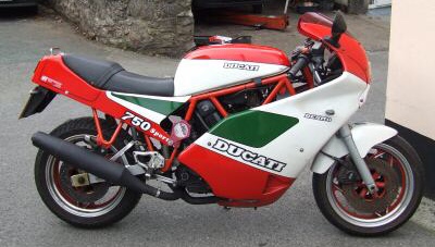

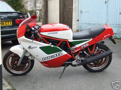

Hi to all on the forum.
I am currently in the market for a 750 Sport. I am off to see one this Sunday but in the meantime I was wondering if anyone could share some wisdom.
Thus far all I know of the bike I am viewing is that it was registered in 1990 and was one of the last sports to leave the factory. It has a Tricolore colourway and its running mikuni carbs ( webbers there with it too). She has been stored for about 6 years so will need some tlc etc etc... I will know more come sunday.
Are these bikes becoming more rarer/sought after as I don't see many about - which I like. I like to be different.
Also this will be my first restoration project - are these bikes easy to work on and are they reliable - I hear they are?!
Anyway here is some pics. I will post better ones on sunday.
Thanks in advance
Cris

Hi Chris , welcome to the mad house . Bike looks good , and the mikuni's are a bonus. The bike itself is a reliable thing as long as it gets the care it needs and there aint nothing special there . Desmo vale gear takes a bit more time to sort and as the adjustment is by shims it isn't just a tweek of a screw to set clearance but they are not complicated , there are one or two pitfalls .
As far as value is concerned , even good ones don't seem to get the money I think they should . I turned one down ( NZ$1500 ) , a real shitter , but on reflection ( yeah yeah :lol: ) I should have bought it ..... even if I just chucked it in a corner for later.
They are a good ride , and if you don't flog the arse of it ( the more time you spend near the redline the more you will have to service the valves ) it will give good service , should be good on fuel. Not to sure about the later models but the older ones usually need the electrix repaired/ modded , again nothing major , add a relay here and there , check grounds and starter cables ( there is a very good upgrade kit available )and general cleaning of plugs and switches.
I would think that now is a good time to buy one as they are not that thick on the ground and originality is probly where the value is . I am pretty sure that if you can do your bit there is nothing we cant sort :)

Nice looking bike! They definitely ride well. A sort of budget F1, with kind of a cult following in the U.K.
