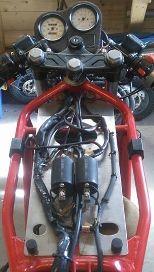

Hello.
Can anyone tell me where I plug connectors to the terminals on a Dyna DC10-1 coil ??
I do not understand completely if it's + and - terminals.

PostPosted: Sun May 01, 2016 11:43 am
The +ve terminals should both be connected to the 12v ignition supply (I believe it is yellow/green on the 750S). The -ve terminals should be connected to the ignition modules, the vertical coil to the vertical module (grey wire?) and the horizontal coil to the horizontal module (light blue / yellow wire?).

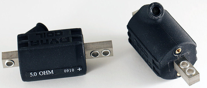

Thanks for reply.
What I do not quite understand is if it is +/- on the coil. There are no marks showing who is + and who are-

PostPosted: Sun May 01, 2016 3:52 pm
the side with the printing is +, the side the ignition wire is -

Thank you for your answer. Appreciate it.
As it appears on my image of the coil is missing the + mark on this. Dont know why.

PostPosted: Mon May 02, 2016 10:03 am
FYI, The info is downlaodable from Dyna in the installation instructions. Section 4 :idea:
basically it states the positive terminal is the one opposite the spark tower :thumbup:
