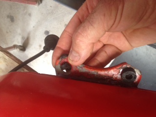

I just made my own with a 30mm long piece of hydraulic hose, cut almost in half leaving just the tube wall thickness uncut, then insert it into the tank holes from the inside not the outside, stainless washer top and bottom and there you go! Bobs your mothers brother !
