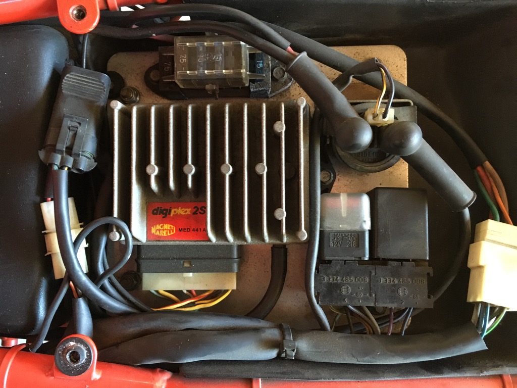

Hi,
My 89 750s has an odd issue. When it's cold the electrics will cut out entirely. No power at all. The starter does not work and the lights in the dash go out. Leave it a few seconds and it comes to life again and the starter fires her up fine.
I had the seat off looking at the wiring and noticed that the relay under the seat clicks off. Now, I'm not sure there is supposed to be a relay. Has someone before me dine the wiring mod? I've posted a picture here. The relay is a 12v fused thing and attached to a combined block with the flasher.
Is the setup I have here standard?

That relay is where Id start looking . Check all 4 wires go where they should. One should come from the ignition sw to trigger the relay , and the other end of that should be earthed . There is a power in wire which should come from either the battery or the fuse box , and go to the main elect feed circuit . Seeing as how it all works eventually Id say all the wires arewhere they should be .... you just have a bad connection somewhere..... shouldn't be hard to find :)

Thanks mate. I'm inclined to agree with you. The relay could be failing too. Am I right in assuming that the relay on the left with the plastic lid is non standard? I guess it doesn't matter if it is or not, it just needs to work :). But I'd be keen to know either way.

That does look like what is under my seat. Looks all stock to me. Yes, one has a fuse in it.
Mine has a zip tie around the two relays and the block to hold everything in place. I guess a previous owner had some issues, so just left it there.
If you haven't yet, pull every connection apart, clean it off, put some silicone dielectric grease on it, cycle it a few times, and put it all back together. Just making a breaking the connection a few times will vastly improve the connection originally made 25 years ago, and the grease will keep it from corroding further.
Another modification is to drill and tap one of those fins to ground the ECU housing, as well as the voltage regulator up front. Ground loops make for funny gremlins.

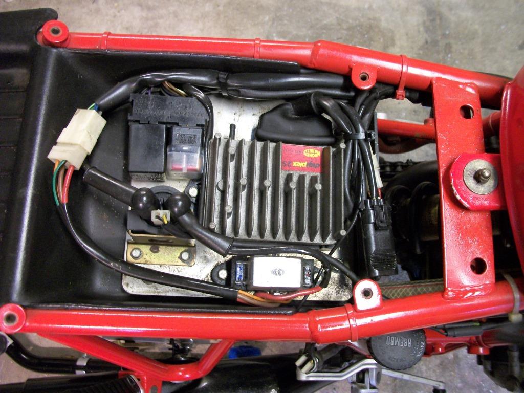

And the same as when I had mine, all looks as it should
