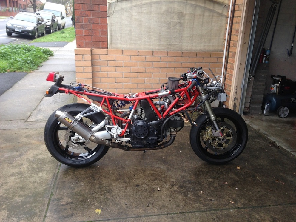

As I bought it.Looks ok but on closer inspection it was pretty slapped together. 88 900ss.jpg
Here it is naked.Have cleaned the frame up and welded some new tangs for the new exhaust hanger .Fitted later swing arm (straight bolt on with a bit of shimming)and fitted the rebuilt shock which I got back today.It's a FG Gubellini which I have never heard of before but the guy who rebuilt it said it is a good shock.Did the front seals in the forks and bled the brakes.The wiring is almost sorted and I have bought a acewell speedo to use while the old clocks are rebuilt.Some how my 2 days off have disappeared.
The front triple clamp is off a 888 which was machined to fit the 998 front end.
Will fit the body work today I hope to take a quick test ride before I strip it again to do the belts and valves.

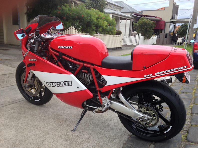

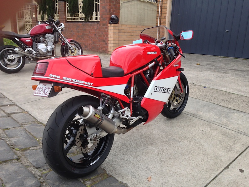

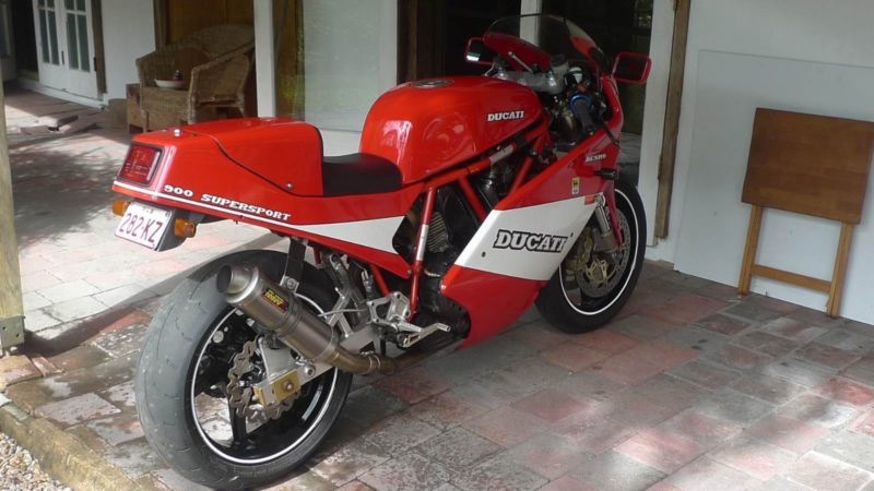

Ready for roadworthy inspection.The motor in this is not stock though the last owner did not say it had been modified but it makes my 93 ss with 41 fcrs and mufflers seem gutless compared to this old girl!Mono's in the first 3 gears off the throttle and revs out much faster than my 93.
