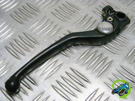

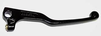

there are for sure ways to loosen that rust.
However there are many different types of Brembo brake & clutch levers and there are adjustable ones that fit also on a Paso/Sport. These if I`m not mistaken were used on the 748/916, early 900ss, Monster and different Guzzis & Laverdas. These are bikes with Brembo PS master cylinders. The levers for the Brembo PSC mcs are different.
