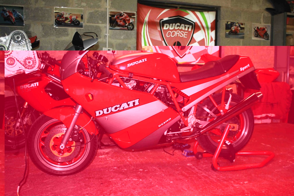

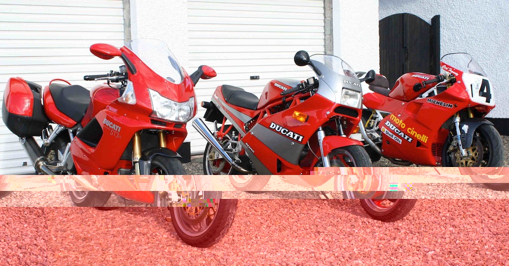

Well finally got the Sport finished and on the road, few niggles held things up (and working on other bikes!) ;
- getting carbs sorted and jetted, have ended up with 132.5 mains (140 too rich), and dynojet needles, perhaps a bit lean but moving needle jet position should sort it.
- forks were terrible - like a set a pogo sticks at the front, no damping at all! I stripped and rebuild them - nothing wrong, Ohlins agent did the same - still terrible, looks like the problem is with the bypass 'valve' on the forks - just does not work. Maxton will fit a set of modern cartridges to them - but cost is over £600 ! Ended up fitting a set of Hagon progressive springs and more reducing the air gap which makes for far stiffer front end (interestingly the Hagon (Wilber) springs are too long to fit with std preload spacer and too short without - ended up using a 40mm preload spacer in them - Hagon were no help and asked that I tell them what sized spacer I used!!)
On the road the wee bike handles pretty well - esp since fitted a nice set of Verlicchi competition clip-ons.

Always a few niggles to sort out. I don't think it ever really ends. But as long as you get a crowd around your bike at the next meet, you know you did good, and you surely should get an audience for that beauty. Nicely done. Lovely pipes.
