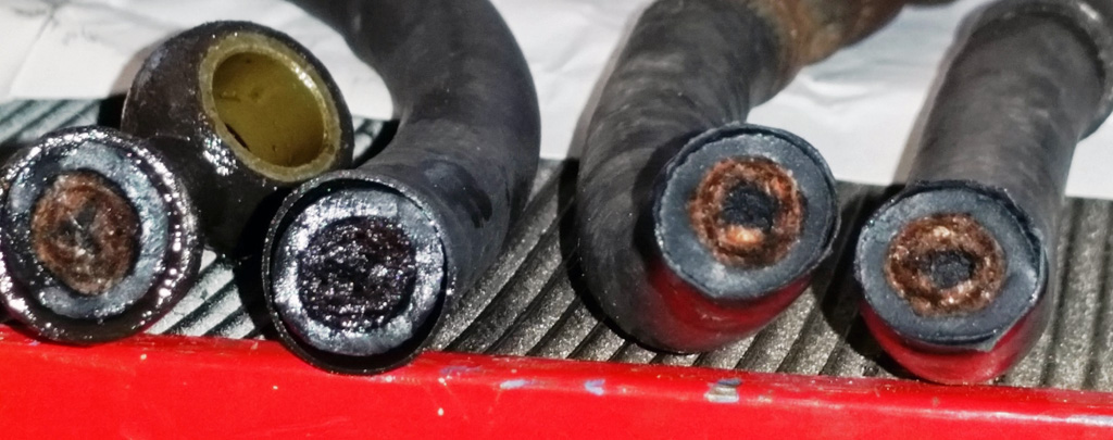

I thought I'd share these pictures I found on a german forum.
The first photo shows new brake hoses just like the ones used on the Paso.
The second are brake hoses removed from an 18 year old BMW K1100. The K1100 was built from '92-'96 meaning that the brake hoses of your Paso are up to 10 years older!
The inner hose has disolved. These hoses might actually still work (somehow) and show no cracks on the outside indicating no obvious aging but in worst case scenario the brakes would not work when really needed or seize once pressure was applied locking up the wheel.
If the brake fluid wasn't changed in a long time it'll probably be black or at least dark but if replaced on regular basis its colour will not necessarily indicate the inner condition of the hoses.
All I mean to say is that just like noone should still be riding on Michelin tires noone should still be using the original and 25-30 year old brake hoses. The industry recommends replacing rubber brake hoses every 8 years which probably noone does. However after decades it must be done. Rubber becomes porous over the years and even if there are no fluid leaks air humidity can get into the system weakening brake performance.
Get over the 'I don't want to spend the money. They still look ok' and get some new ones. You'll notice the differemce of fresh brake hoses specially if they are steel braided ones which btw are not only better but may cost less than original rubber ones.
Finding those pictures I just felt this should be pointed out.

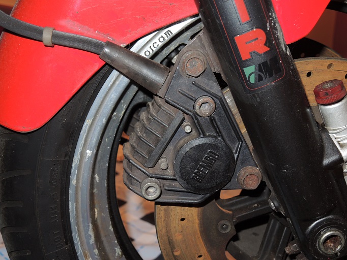

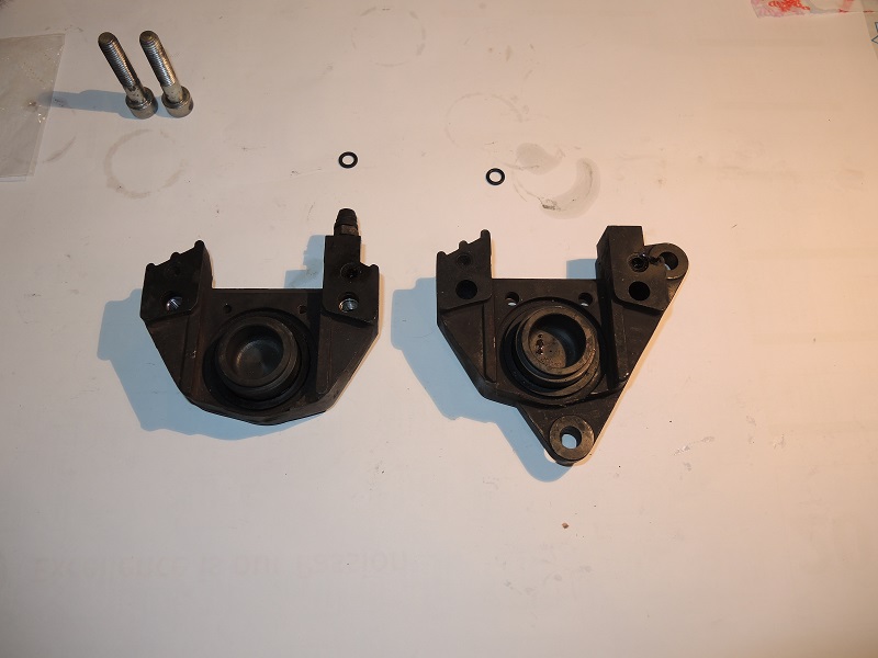

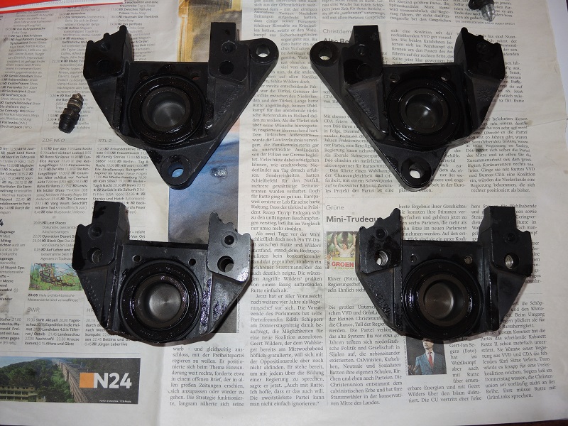

1.) Brake calipers
- also the seals in the brake calipers get old and cracked and need to be replaced
- pistons can be damaged due to corrosion. I experienced this when I took apart my brake calipers. On one piston a bit of the coating was damaged, causing the seal not to seal properly anymore. Luckily, I had a replacement piston in perfect condition.
- Removing the bolts which hold together the two caliper halves can be a pain in the arse as galvanic corrosion causes them to get severely stuck in the aluminium housings. I had them removed by an overhaul company as they have the proper tools for this.
- the Brembo gasket replacement sets can be easily ordered (I ordered mine via Stein-Dinse). Check the parts catalogue for the right article number. No problem for the front calipers, as those sets fully fit. For the rear caliper there’s the problem that there is no dedicated replacement set available anymore. Therefore, I used a set for the front brakes and re-used the four original 8 mm bolts which were still in good condition. The front calipers are assembled with two 10 mm bolts, which are in the replacement set. On top of that the rear caliper contains two small o-rings instead of only one in the front calipers. This second o-ring is not included in the replacement set. I mounted an EPDM70 o-ring (= ethylene propylene rubber, which is resistant against DOT 4 and DOT 3 brake fluids) with measurements (Inner diameter ring x diameter o-ring material itself) 6,75 mm x 1,78 mm.
- I thoroughly cleaned the calipers and pistons, before mounting the fresh seals following the instructions
- re-assembly of the calipers halves: I put a bit of aluminium anti-seize on the bolts before tightening them with the right torque.

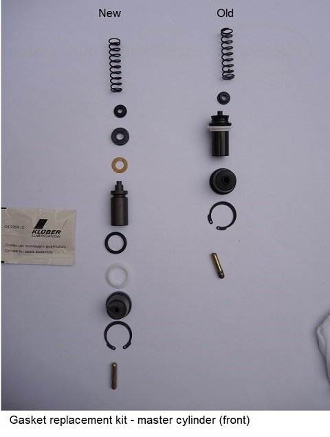

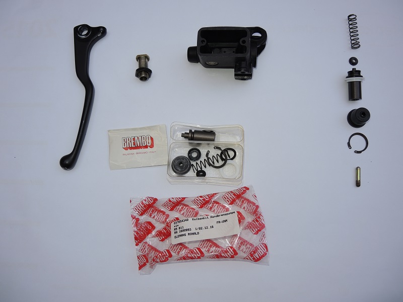

3.) Front master pump
- Gasket replacement sets can be bought and replaced easily
- The set is being held in the pump housing with an external circlip, making replacement easy. The clutch master cylinder is quite a different story! There’s no circlip there, but a sort of hemispherical steel ring which must be punched into the housing to keep the piston and its seal in their position. Really a monstrous construction if you don’t have the proper tools for this. I tried it without them, but I failed. So, I had to sacrifice a brand new gasket replacement set in order to find out it’s better to go to a Brembo specialist to have them replace the piston and seal.

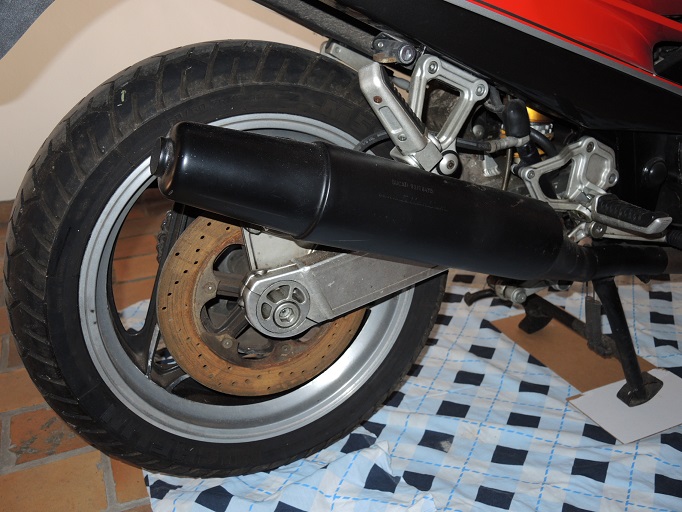

4.) Rear master pump
- Another good reason for going for a full overhaul of your brake system. See the rubber o-ring in the masterpump housing being cracked after many years (see pictures below)
- Original replacement master pumps (PS 12) are not available anymore, but I found a very good alternative for a reasonable price (see the PS 11 on this page: https://www.ducatipaddy.com/page29.html )

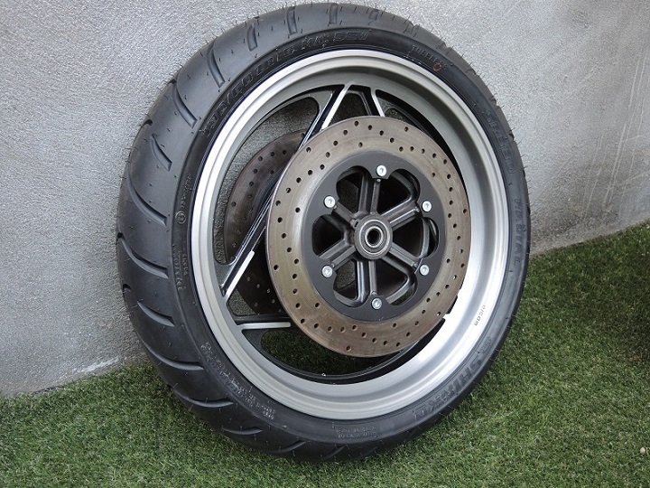

5.) Brake discs
- The inner diameters of the brake discs are galvanized or nickel plated (??). After many years this ‘golden look’ is gone and rust is all that remains. I looked for a company, which could redo the plating for me, but I didn’t find anyone. For this reason, I decided to clean the discs and paint the inner diameter with black heat resistant paint which I still had from repainting my mufflers. Not original, but it looks tidy again.
- the mounting bolts for the brake discs are available via your Ducati dealer

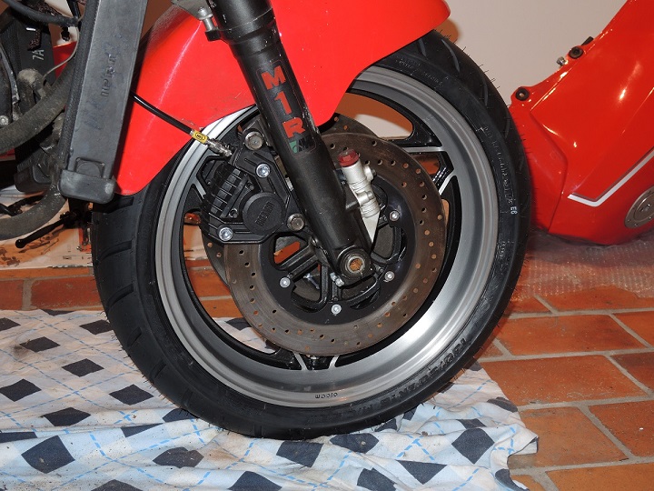

Picture of the refitted front wheel with overhauled brake calipers, new brake line and repainted brake discs (inner diameter only of course).
