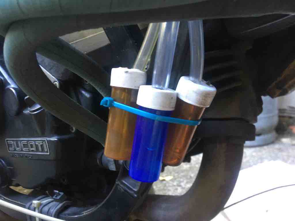

I made 3 lines for the overflows one from each carb and one for the T between them. On the end of the lines I placed small plastic pill bottles, this allowed me to see any fuel and which outlet it came from, this system really works as I started with an overpressuried pump (solved using a by pass) and one carb got some grit in it, (from the by pass) then flooded, it was all easy to see where the fuel was coming from.. and these can stay to be checked if I feel the need.

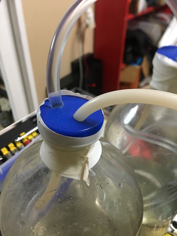

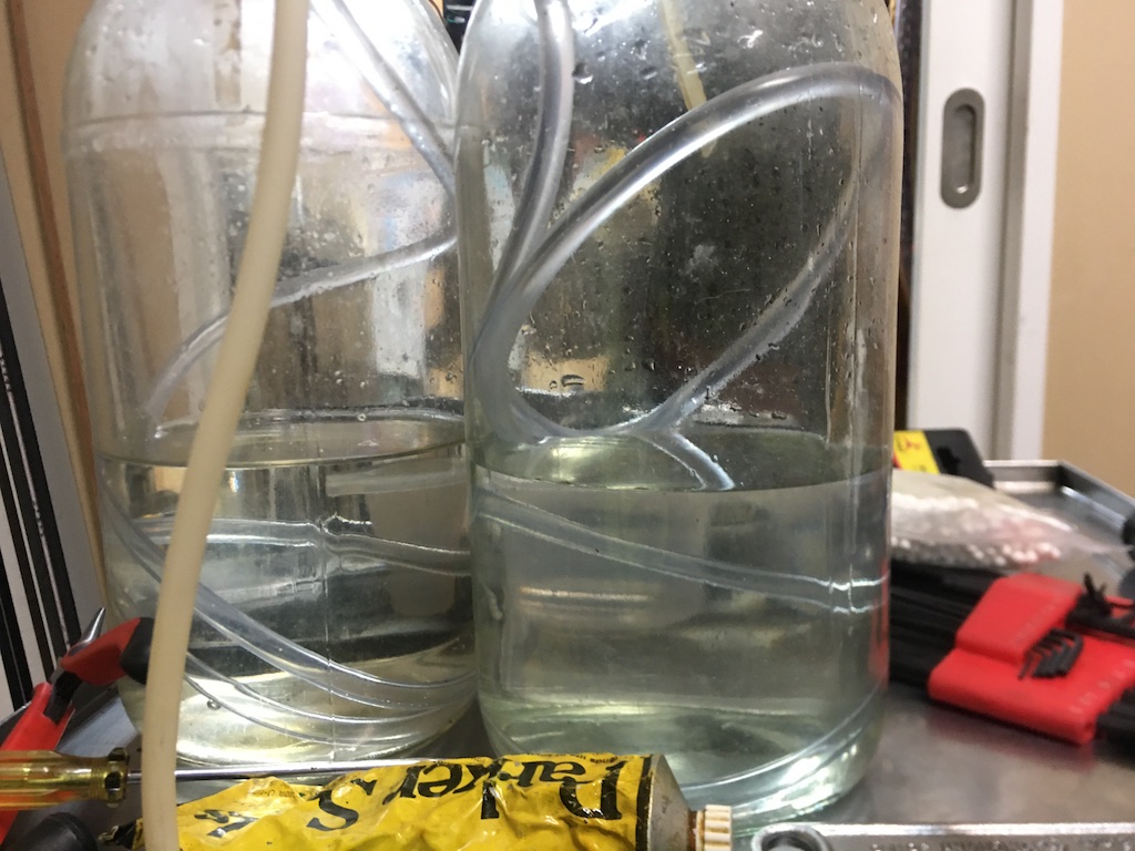

A useful tool I created for balancing might be of interest to others, it's cheap and accurate
get 2 big glass bottles, 2 plastic caps with 2 holes in them for plastic tube, build it so there is long tube to transfer the water between the bottles, this joins the bottles together so when vacuum is applied to bottles water flows one way or the other, coil the tube inside the bottles ..
the other tubes connect the manifolds one to each bottle.
add water (make sure you don't fill more than a third of a bottle, if you put too much water in there is the danger of sucking water into the engine)
put a light behind it if you want to get sophisticated or stylish
Start the engine and set to a fast idle, you want to balance at 3500 - 4000 rpm, watch whats going on, the water will pass from one bottle to the other, when you tweak the carb adjustment the water will slow, speed up or reverse flow. I found the most precise adjustment was obtained by letting the water run from one bottle and fill the transfer tube with bubbles, by watching the movement of the bubbles in the tube the adjustment was really sensitive but accurate.. (rather than the water levels inside the bottles)
The adjustment difference would have been 1/8 of a turn (if that) between the bubbles going one way, stopping then flowing back, play with this for a while and you will realise how accurate a technique this is ...
