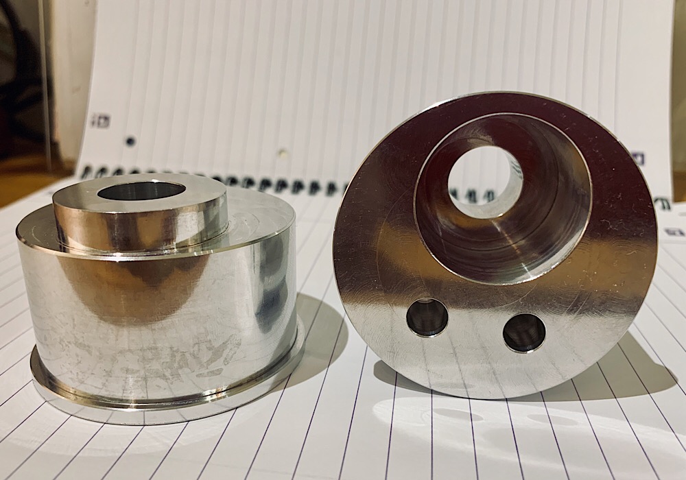

Hi
I went with new chain adjusters machined to take 17mm spindle...collected today!
