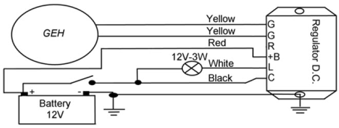

Derek, it seems you're right. But if you look at other regulators tho the black is the sensor wire i.e. Electrex ESR540 or an original Ducati Energia regulator (pic below).
Also in the Electrex ESR510 instruction the black wire is mentioned.
Some regulators have a black ground wire, on others the ground wire is green.

it's either that or double up the yellow from the stator and connect those to one yellow from the regulator and the red of the stator to the other yellow of the regulator as per the Electrex/Electrosport instructions (first link posted). Since you verified that black is ground an additional wire to the case is not necessary.
