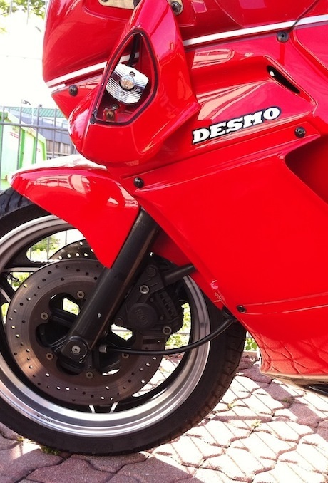

Never dropped a Paso, but today it happened.
Was coming to a 3 way, with my street being at about 60 deg to the main street,
and a 20 year old cut the turn, coming in my lane.
Braked hard and he missed me by a palm or so,
but the bike started leaning and it went far enough that I couldn't hold it.
So I put it down slowly, as I listened to the turn signal lens crack.
Obviously some scratches on the mirror and since it came off it scratched the windscreen
near the mounting, some scratches on the oil cooler cover, and on the clutch lever.
All pretty light, and it could have been a whole lot worse but I'm pissed nonetheless.
This BMW poser's insurance is supposed to pay but I'm concerned about paint matching,
this being the orig. paint. Any tips on that? On the windscreen, can they paint around
the orig. decal without it looking silly?
Regarding keeping the bike upright when it already leaned part of the way.
I needed to use my legs to push it back up (after I destroyed my back to get it to knee level ;),
but obviously when it's starting to lean, catching it with one's legs is not always an option.
Any other ideas, besides working out, eating spinach and all that.

PS: There was a bit of fuel on the street, but also some oil.
Any idea where the oil would come from?
Starts, drives fine.

And the picture.

 Post subject: Re: And, it finally happened ...
PostPosted: Wed May 21, 2014 4:12 pm
Posts: 257
Location: The Netherlands
left side..? Wild guess: the spot where the cables run trough the alternator cover..?

Since gasoline was dumped from the overflow on the exhaust,
I was wondering if any Paso's caught on fire like this?
With Ferrari's, and I guess other mid-engine cars, it's quite a common occurrence
to end up with a big fire from gasoline on a hot exhaust.
PostPosted: Thu May 22, 2014 8:42 pm
At the base of the breather is a separator valve meant to allow the oil vapors in the crankcase to settle out of the air.
When you put the engine on its side oil leaks trough the valve and out the hose and ends up in the big black tank in front of the battery which is meant to collect what oil does not get separated out. You most likely just dumped out what was in that black tank...thick and black
PostPosted: Sun May 25, 2014 12:46 am
Joined: Wed Jun 20, 2012 11:37 am
Posts: 32
If you want to match the paint, take the bike or a panel to an automotive paint store. They can use a spectrometer to match the paint perfectly. You can order new decals from England and are not that expensive. I think I paid about $80 US for the entire set but you can order a specific one and just pay for that one or two. Let me know and I can give you the paint code for a red '87 Paso and can give you the company's name for the decals. I went through all this when I top sided my Paso two years ago thanks to the 14 year old slick tires.

the paint I got is Dupont ChromaBase BC, Blaze Red
563444 K H
850J 88.0 88.0
802J 100.9 12.9
866J 112.1 11.2
150K 352.1 240.0
175K 432.2 80.1
VS:2 VOC-LE: 5.7 VOC-AP: 4.8
I hope that helps
