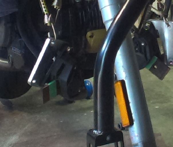

model: other
With the 17” conversion on my Sport, can’t actually get to the bleed nipples, so the procedure is to go through all the kerfuffle of removing the front wheel, re attaching the caliper’s to the fork legs, put the axle back in to hold the forks in place then bleed them as you would on any other bike, obviously using some form of wedge a similar thickness to the disc rotors to keep the pads apart, I just use a piece of Masonite with the edges bevelled.
Then put the mongrel bastard all back together again, truly is a pain but works for me. :banghead:
