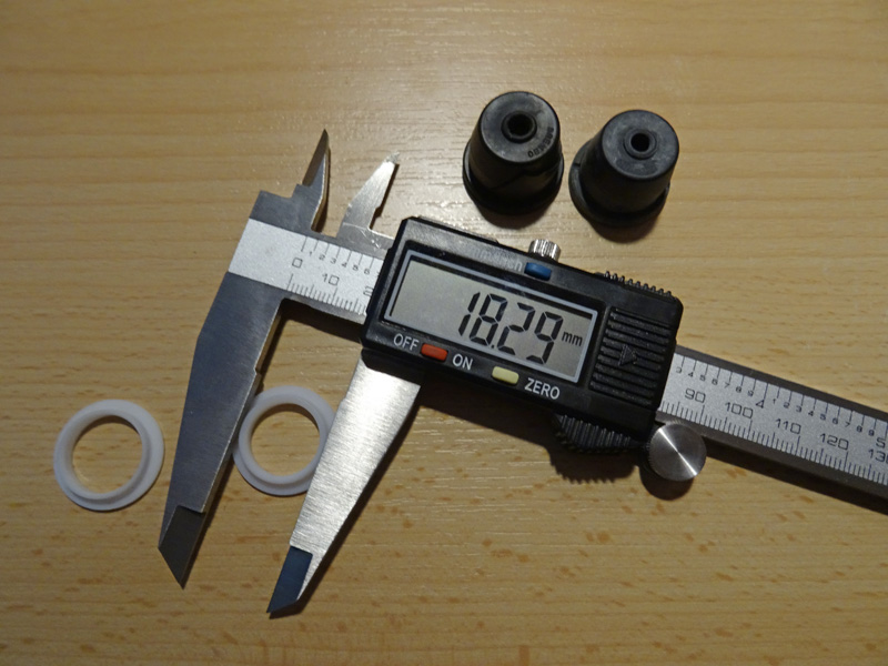

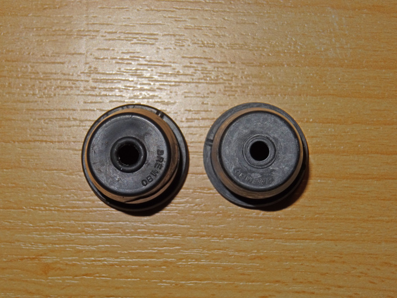

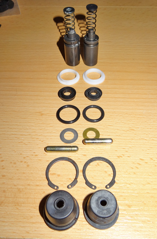

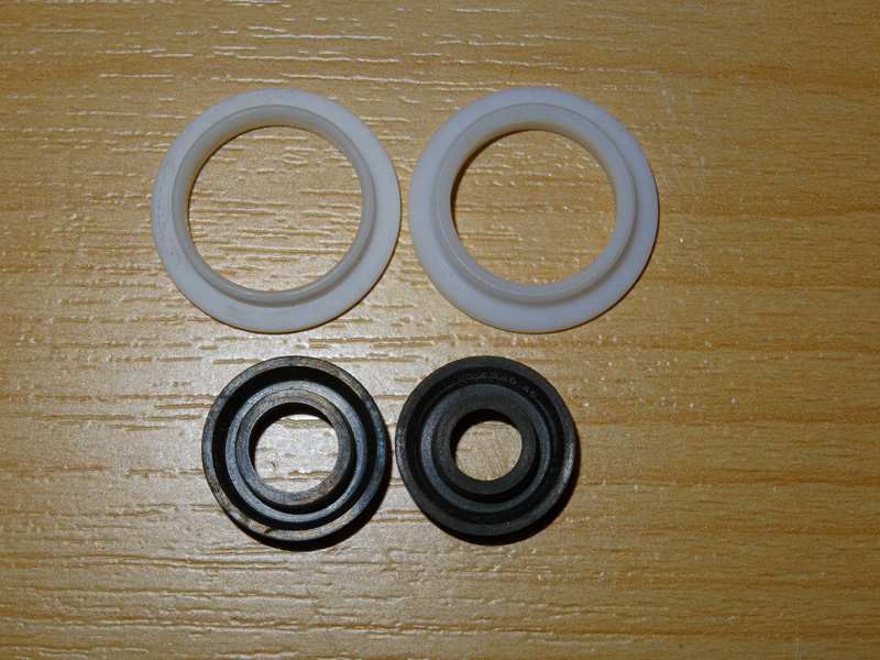

Frank, here're the used parts of the PS16 on the left vs. the new PS15 parts on the right.
The outer diameter of the white plastic rings is the same as is the outer diameter of the edge where the rubber boot sits. So I'm lucky and the rubber boot of the PS15 kit will fit in the PS16 m/c. The rubber boot of the PS13 rep.kit won't fit. It is smaller.
I wonder about the longer spring in the PS15 kit. The length of both pistons is identical. Maybe the depth of the cylinders isn't. I doubt the used spring set so much.

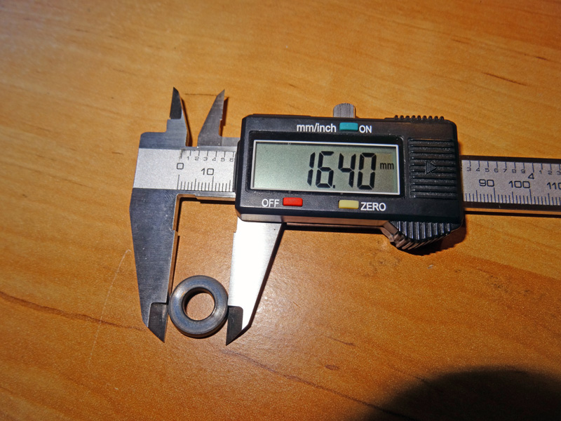

Gerhard,
Ok, well done!

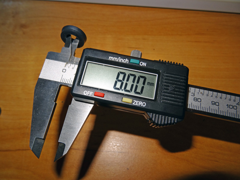

So, if you could measure up the 16mm brake fluid seal (and maybe the 15mm aswell), ID,OD & width we could see if we can find an acceptable substitute if needed in the future ….
Just to bad that the dust seals are not sold separately (as do the radial & semiradial masters from Brembo).
The spring is hardly significant in m.h.o. it will give a little more preload but the force is not substantial compared to the applied braking force (full pull that is).

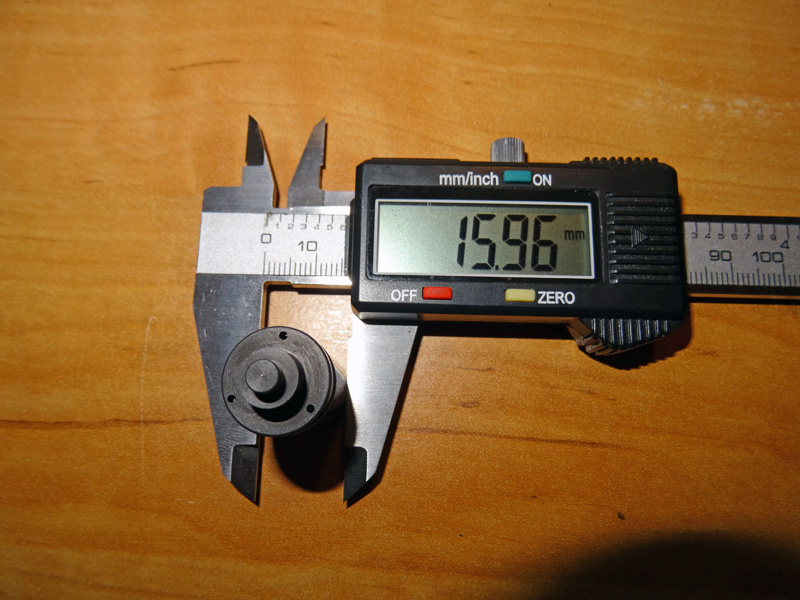

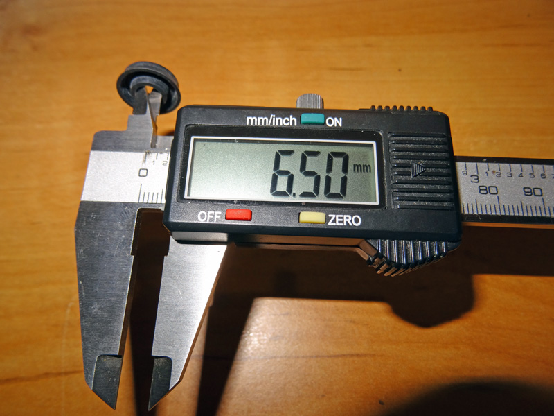

 Post subject: Re: master cylinder rebuild - a few thoughts and my experien
PostPosted: Fri Jun 05, 2020 12:08 pm

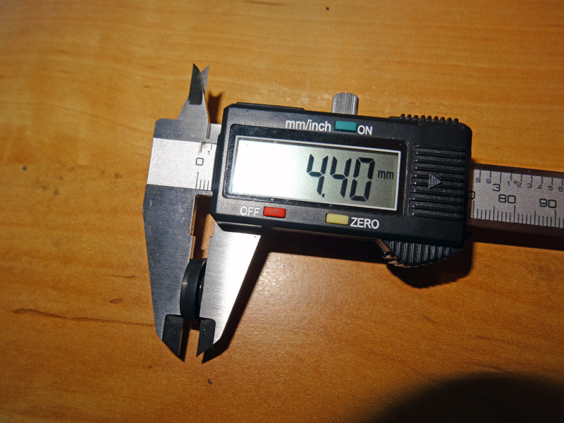

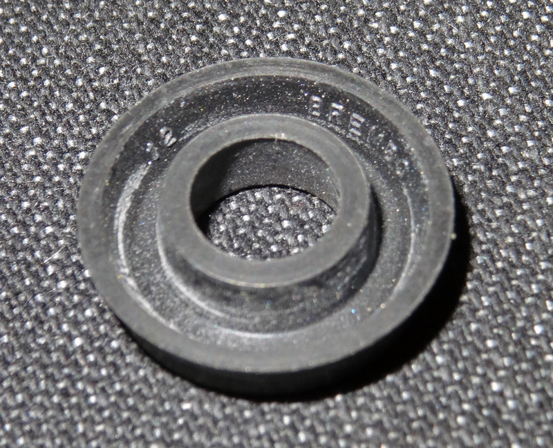

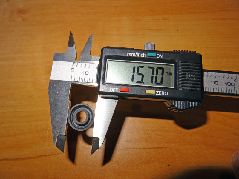

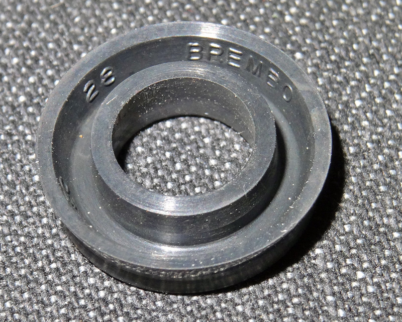

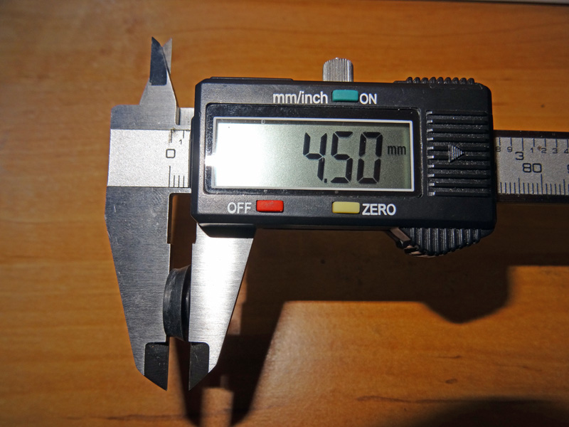

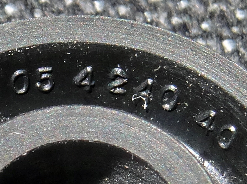

PS15

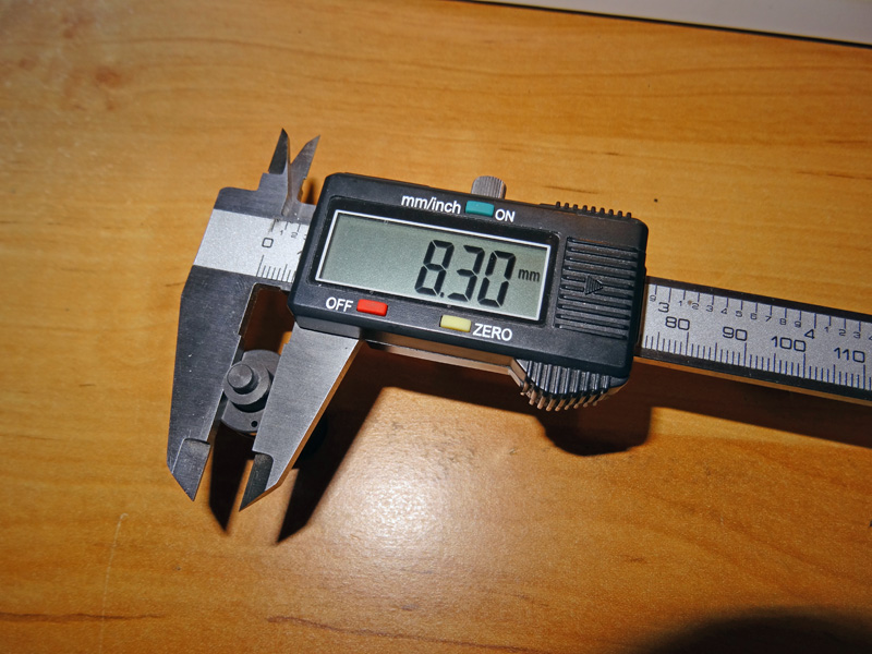

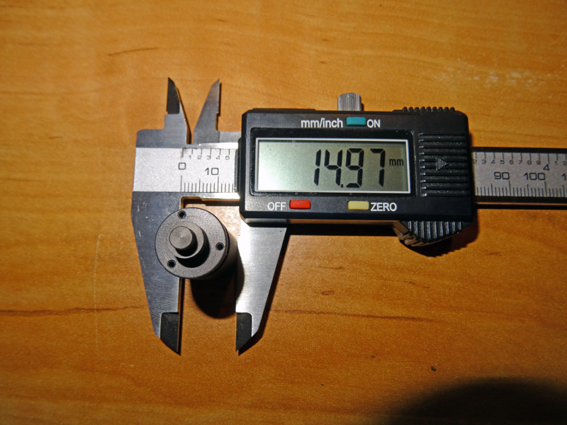

Dimensions of the seal:
Height: 4,5mm
Inner diameter: 6,5mm (Diameter of the piston where the seal sits: 7,3mm)
Outer diameter: 15,7mm (Diameter of the piston 14,97mm)
#05424040

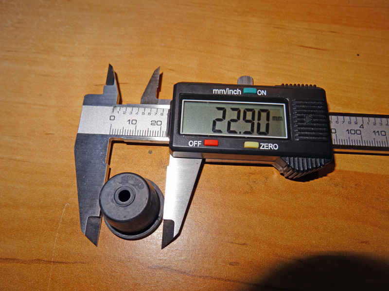

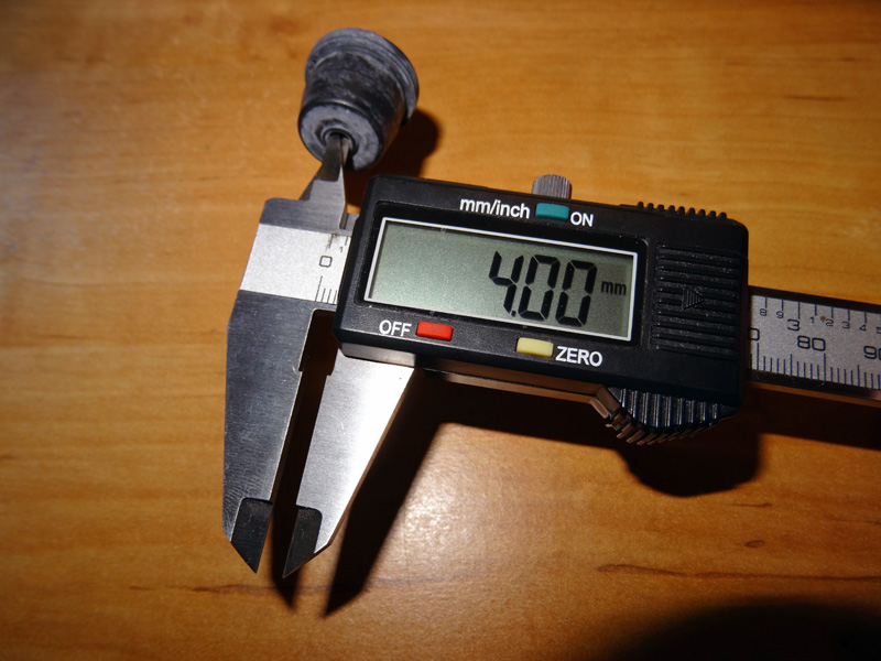

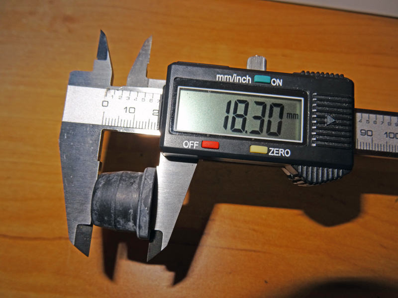

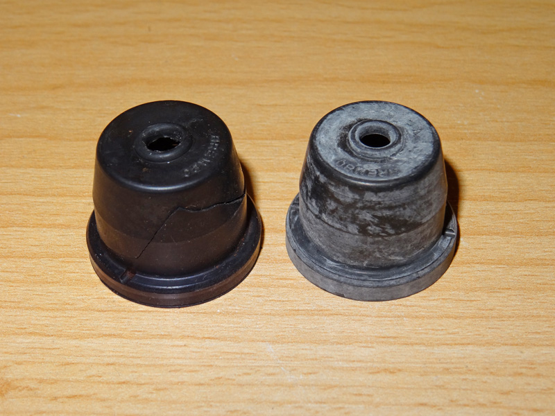

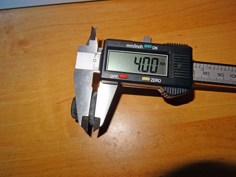

PS15/16 rubber dust boot
Dimensions of the rubber dust boot:
Hole on the top: 4mm (diameter of the actuator pin: 4,97mm)
Bottom (outer) diameter: 22,9mm
Height: 18,3mm
Height of the bottom lip: 4mm
Thickness of the bottom lip: 2,5mm

PostPosted: Fri Jun 12, 2020 7:01 am
Posts: 86
Just to add my own experience into the discussion I have had issues with incorrect size ‘lock rings with brembos’ on a couple of occasions over the last 20 years. The locking ring had insufficient interference to the bore to successfully hold the assembly in place. In the end I made my own ring on my lathe. I guessed I was just unlucky but I mention this to a friend who has done far more than me and says he has had this problem as well. Looks like brembo made up a batch of these kits with either the wrong locking ring or an incorrectly manufactured ring. Point is if this happens to you, your not special!!! Get to a lathe (or good luck with returning an opened Brake seal kit! LOL
