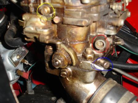

Try cleaning the idle jets first, and run the bike for a while after the cleaning. The idle jets, being so small, tend to gum up when the bike has been sitting for a while. If that doesn't seem to help then adjust the idle mixture on both cylinders. I know that my bike can be sensitive to idle adjustment, with similar symptoms to what you describe, if the idle mixture screw is off by even 1/2 turn on one cylinder.
For reference, the idle jets are held by the screw-in carriers circled in yellow in the attached photo and the idle mixture adjustment screws are the ones circled in blue (sorry for the crappy picture quality!).
While you have the idle jets out of the carb, spray some carb cleaner through the open passages in the carb.
Also make sure that the air bypass screws are closed (circled in red), if one is open too far it may also have an effect on idle operation.

The idle mixture screws are fuel regulators. They screw in to make the mixture leaner. They are very sensitive, so use small increments.
The simplest way to adjust the idle is to set the idle speed to around 1000 rpm using the throttle stop, then pull one spark plug wire, adjust the idle mixture for the highest idle speed on the running cylinder, then do the same for the other cylinder, then re-adjust the idle speed back to normal via the throttle stop screw.
The air bleed screws are to adjust the vacuum balance between the cylinders at idle. If you have a vacuum gauge, all you need to do is compare the two cylinder readings, then open the air bleed screw on the cylinder with the highest vacuum to reduce the vacuum to the same level as the other cylinder. The bleed screw on the cylinder with the lowest vacuum remains closed. If a large adjustment is required (like 1 turn or more), you may need to re-adjust the idle mixture.

Sorry, forgot to point out that the vacuum gauge lines should be connected to the ports on each side of the carburetor, just above the outlet manifold. In the picture from the post above, one of the ports (and the blocking screw) can be seen just below the accelerator pump cam. The other one is in the same relative position on the other side of the carb.
