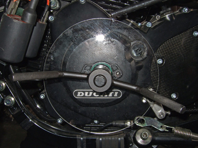

Hail to the inventor of transparent timing discs with black printing :banghead:
