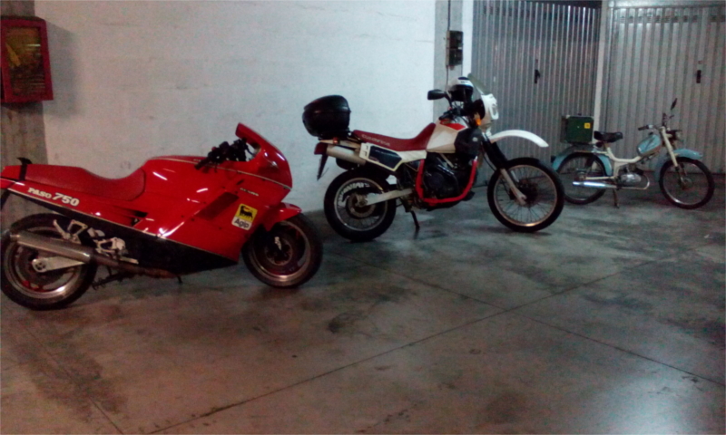

I am happy, I will go home with skizzo, my little 1968 50cc so today I rode all 3 of them
