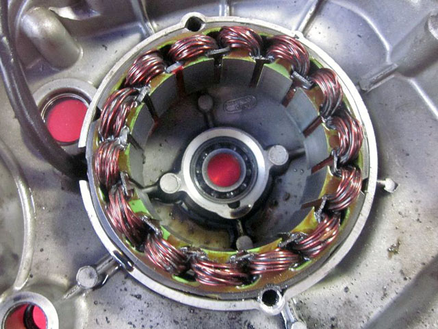

Does anyone have a picture of the inside of the stator cover with the stator still in it? I need to run the wire from the stator but it's not clear how it stays clear of the flywheel.

if this helps. The wires coming out of the stator face the cover.

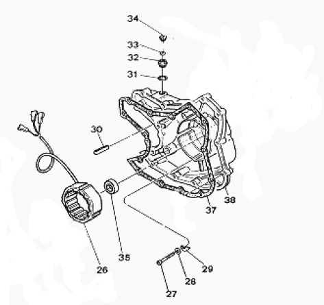

it looks like there is a piece of rubber (#30) which is stuck in the upper gap to hold the wires against the cover.

#066049520
http://www.stein-dinse.biz/Complete-par ... anguage=en

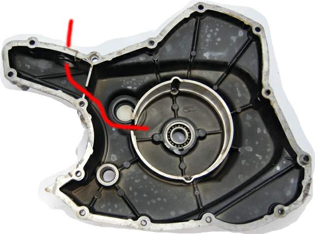

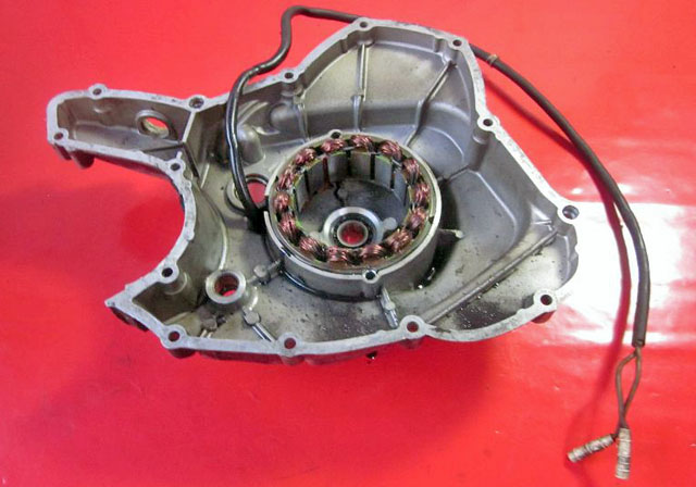

Yep. I got that. I'm more concerned about the cable between where it exits the stator and gets to the rubber block. There's not much clearance in there between the flywheel and the cover and there's nothing holding the cable down. If the cable creeps after the cover is put on the flywheel will come in contact with it.

From where the stator is mounted to the gap the wires pass and are held down by that rubber block there are maybe 2 inches. The wires in the rubber tube are not that flexible so where and how would the cable creep ?
All our engine covers are like that.
